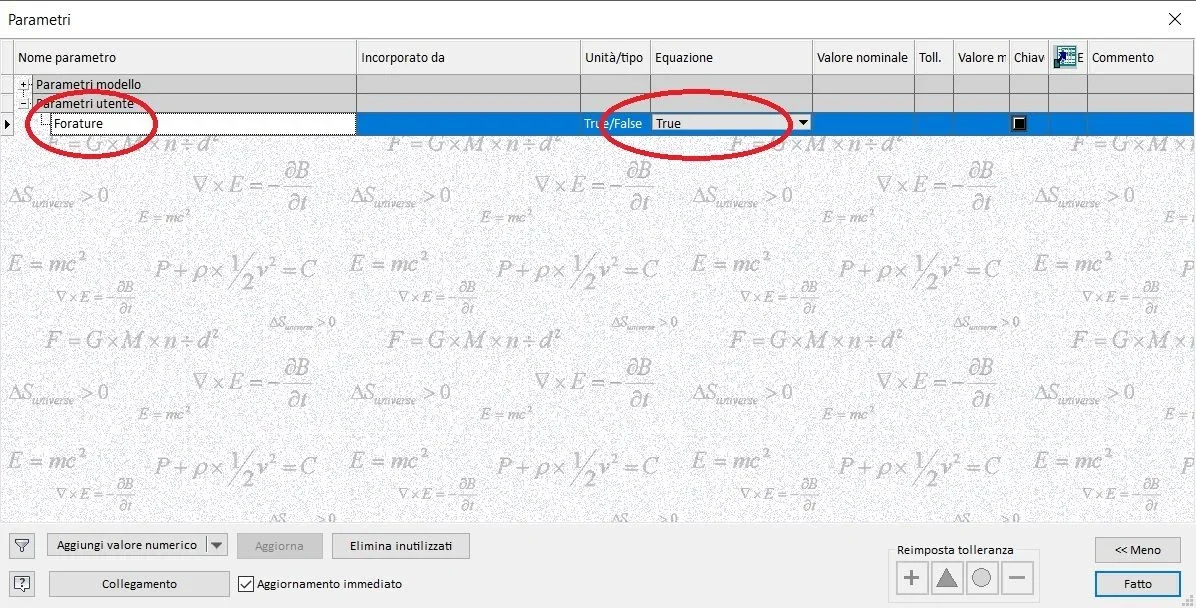

I would need to activate and/or turn off a series of processing automatically and I would have thought of using a Boolean parameter to automate the process.
is it possible to connect the commands "supper machining" and "discover processing" to the parameter, so that changing the value of the parameter compaiano and/or disappear the combined processing?
below some exemplary illustrations to explain better:

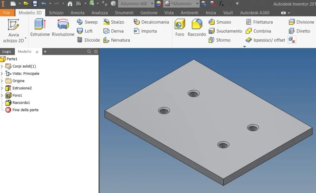

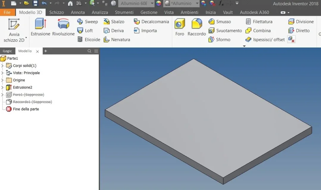

the parameter I would like to useParametro.webpwhen the parameter has true value processing is activeTrue.webpwhen the parameter has false value the processing is suppressed.False.webpthanks to all in advance for any advice

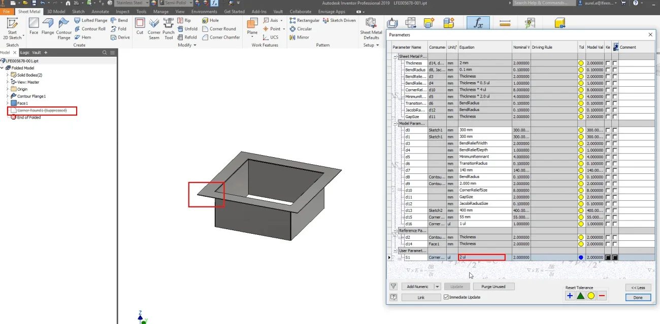

I don't think it's possible directly in the parameters tab.

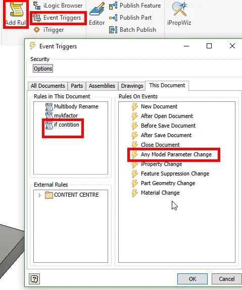

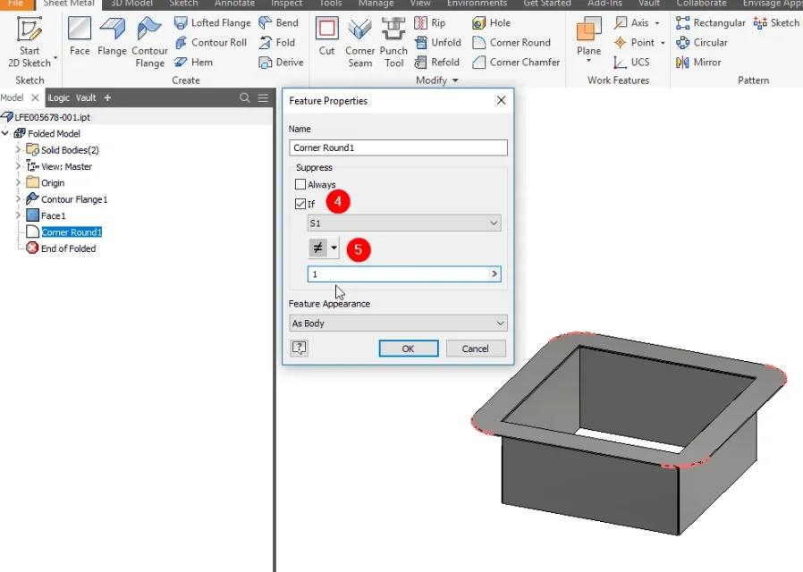

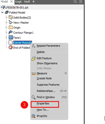

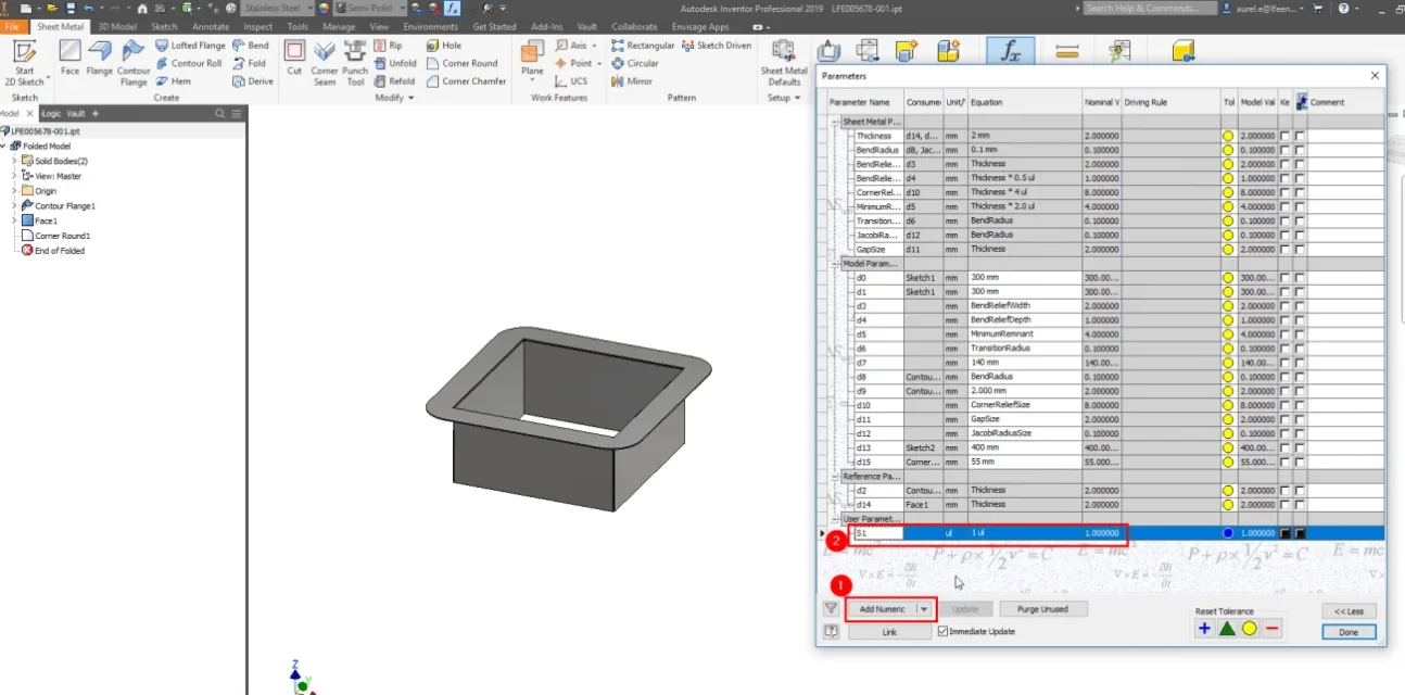

option 1: create ilogic rule and activate trigger automatically after each change in size2019-09-13 13_56_55-Autodesk Inventor Professional 2019.webp 2019-09-13 13_49_07-Edit Rule_ Rule2.webpoption 2: create a built-in excel file - create the condition in the xl file - paste the result into the inventor tabell parameters as linked parameter

I managed to run option 1 with the following code:
Code:
if tipo = "pp" then
z_pg = z_pp
else if tipo = "map" then
z_pg = z_map
else if tipo = "skin" then
z_pg = z_skin
end if
