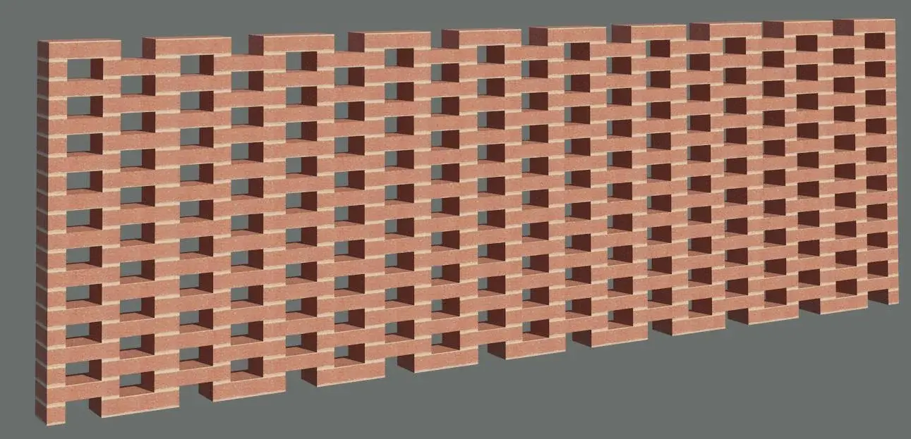

hello to all, I am looking for a wall like that of barns, full brick and perforated I attach an example in 2d. I searched but I did not find such families

with a wise use of photoshop or photopaint
you can do

use of a map with crops when there are larger thicknesses than a sheet metal shows the inside of the empty wall and is not the max.
the only one is to create a family of holes on the wall

if the problem is "make the blanks" read the discussion above linked; if the problem is to create/manage families, you must start from the abc (in this case, start with a good manual ...)
thank you for the answer .I downloaded the blank and I am working on it .in fact I was looking for something more effective like the beautiful perforated wall of which present the photo .. is it possible to download it?

Now that I have presented myself, if you want to give me a hand I will gladly listen to you. My problem is to represent in a facade six perforated areas with a cross hole (six windows closed by a bunch of holes).
I made an area . only that I placed the hole to the eye... and now I have to retouch it.for the others I prepare a grid for laying and the craft goes. the hole of gfrank I was very useful .if you can suggest something else .. thank you in advance.

Forgive me, but where did you read I gave you some jerk? I just said I think you didn't understand revit. walls are system families, you can't download them from the internet like 3d models. the best solution, in my opinion, is to render54, with a nice cutout map. otherwise as you were suggested try to practice with host-based loadable families
