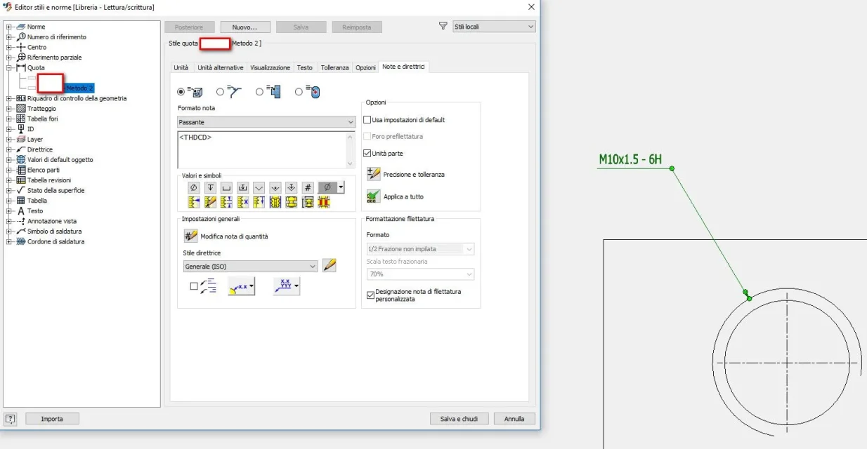

Hello, but if one only wants to quote a threaded hole m5 without x1 and other things, but how do you do it??
I feared this answer... .or enter the portion editing window and delete what you don't care or create a style to get the share as you want.
This is the solution.or change the thread excel table
in the excell file under the design folder date > xls > thread.xls you need to change the cell where there is m5x1 and consequently it is listed as you wantwhere is the path of the tables?
