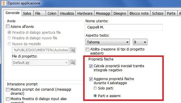

also remember to activate the options of recalculating the mass in files - options_foto__136.webp

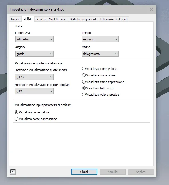

I don't want to say a stupid thing but it's already out in kg, check in the physical tab of iproperties
1581414838650.webpI checked, you can change from the document setting.
then you have to update all the already made ipts and update your templates so the next comes out in kg
View attachment 56241I checked, you can change from the document setting.
they come out in kg in the physical, but in the custom iproperties with =<mass> I'm in gram
