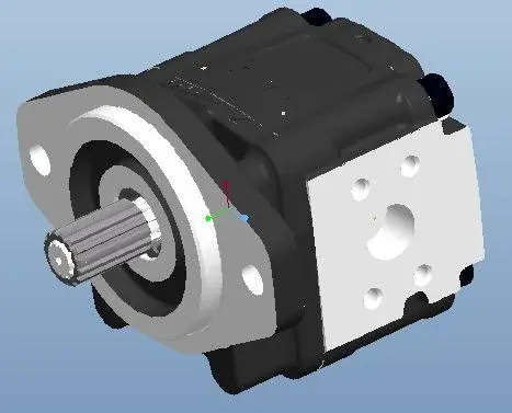

You should see the file, it's hard to give you suggestions without understanding what it is.
the analysis of the area you can do by excluding even after the surfaces you do not care.
I attach a screenshot....we basically say that I should measure the dark gray surface.

select all surfaces and with the ctrl key exclude those that do not interest you in the analysis.
you can also make a copy-paste of the affected surfaces and save the analysis performed.
the fact is that being all rounded has thousands of small surfaces....with ctrl becoming old.....however I would say that thanks to your help I think I have solved.

no, you must first select them all, with the Shift key or right click to change the selection context and then uncheck what you don't care about with the ctrl key.
