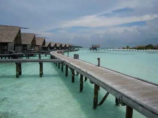

2) the altarpieces being, of course, raised from the ground will have access from wooden walkway, which from the embankment descends to the access share of the accommodation. so how to make the support poles of the wooden catwalk, but then I don't know how to connect beams and assemblies.

the catwalk reflects these three images a lot.
poles that go up to create then with elements the parapet and or vviously of the beams as in the third image that regga the axis for the cycle-pedonal passage.
if you do not plan to pass the file to a stutturist (which would need to work on the poles as pillars) that you use revit I would do everything with the continuous facades.... better two, one for the poles (only mounted with empty system panel) and one for the horizontal axis, which then is what would be done in reality. this will give you maximum freedom to adjust the various elements according to the path.
would have its advantages even using a railing, depends on what data you want to pull out at the end.
another method can be:
- support structure with family of beams and pillars
- walking with floor family
- parapet with railing family (current only)
