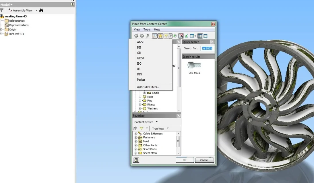

the 5931 are present in inventor libraries, if you do not find the cases are two
1- were not installed during the installation of the program (if I don't remember badly there is not the "uni" family but "other parts" or something)
2- You have selected filters in the content center (the window with the basic filters see it attached)
