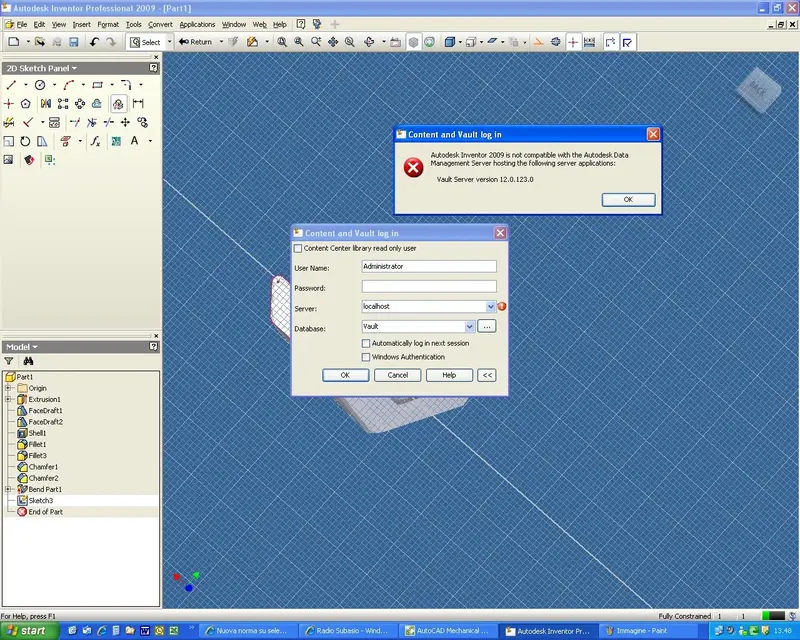

Forgive me,
Can someone tell me why I get this message when I go to call the cc?? ?
ok thanks for the good news.... tips to solve the problem?? ? ?
Should I reinstall? ? ?
Do I have to give up? ? ? ?
I'm going to lurdes? ? ?
:confused::confused:
if the operating system is in Italian, write administrator instead of administrator.
testing usually works
I changed the link previously entered, now you should find the answer to your problem.
I am cautious because what I have indicated in that answer is a slightly slender solution, to be implemented in the moment of maximum despair.
Do you have multiple versions of inventor installed?
Bye.
Yes!
inventor prof. 10 in Italian and 2009 prof. in English! !
Is that the problem? ? ?
however taken by a raprus I uninstalled and went on to reinstall. ....
I really have to go to vacation! ! ! ! !
Yes!
It could be, we say it's safe.
have you mounted all the service packs?
The adms are very important.
Did you take a look at the link I indicated you most on?
