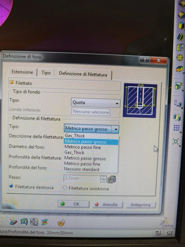

Good morning. Has anyone ever tried to change thread parameters on catia v5? because I changed the parameters within the program installed on the pc, thread folder, and on catpart new no problem, takes the parameters of the threads I entered, but if I work on the company's server, with projects already made, and I want to insert a new thread hole takes the old parameters. on the tool/standard window the parameters are new ones and I can't understand how to do to permanently modify them even on the already present catpart without having to go to memory the old parameters. I hope to have been as clear as possible and I thank in advance who will help me.

Meanwhile I thank you and I bovinamente did a search in the pc and server, changing and inserting the thread folder with the new parameters and deleting the old, other I did not find and anyway I remain this problem also with cat restart. I had not actually looked into the environment editor and the catcollectionstandard folder does not point anything like a lot of files. how can you insert the correct path?
on these variables you need to insert paths where your files are located
environment editor you have to open it as administrator .. otherwise it is read-only.
1706612241019.pngand in the c folder: my_standard you will put these files
1706612504999.pngthen there is the speech of the catsetting..

the catusersettingpath I can't change the address because otherwise it doesn't find the licenses, while I have pointed the existing standard folder with the files that you entered as "myi_standard" for the other two cats and besides that I still don't take the new parameters unfolded me the old ones when opening the curtain. always on existing project. all this to simplify work on worknc that does not see threads as it does catia with the set standards.
on existing catparts there is no other way than to individually replace threaded holes with the new standard.
you place on the threaded hole and check the new standard. (Marian friar work)
on new ones you can start with the modified standard.

The problem is that I don't want to find the new standard in old catparts, so I can't even do the work as a Carthonian friar that I still put my soul in peace to do it.

I really thank you so much for the tips and in the end I opted to do new part so as not to knock too much on the strings of the programs, otherwise I would have done another job. thanks again and good day.
ciao @zilla157I have a doubt
the fact that it doubled your files means that the new modified standard is there
I would change name to your edited files
for example "wnc_passo_grosso" "wnc_passo_fine" "wnc_gas"
can be that having given the same name.. Catia take the first of the list that is the original one.

was the obvious thing to do, rightly to change its name and address to put standards. Now it works, Thank you so much!! ! ! You know when you go thinking about the hardest things and don't think about the simplest thing that works.
