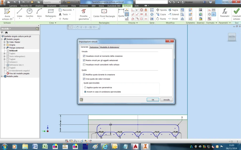

environment .ipt:
tools- > application-> sketch- >change quotas to creation.
this option creates the inconvenience (to me) that occasionally loses the tick, but it is not a great harm, just quit.
in 2015 this option is no longer there, it's by default, so I imagined that by removing the option there was no more inconvenience.
but I don't know how to reactivate it.
there is an equal option in tools-> application-> drawing options, but has no effect on parts sketches.
at the moment to get it back is not enough to close the program, I have to restart the pc.

http://knowledge.autodesk.com/suppo...6dfaa88a-0c90-429e-a694-aff93730c095-htm.html
That's where they put the option.
Was it disgusting to leave her where she was always? :36_1_28:
at least he had no fault of losing the tick! :36_1_28:
Thanks for the tip. :4425:
