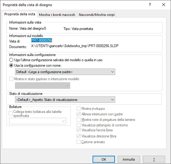

Another question: is there a possibility of making sure that the interruption of a view interrupted also in other derived views is affected? or do you have to do it manually? ?
first make the main view, interrupt it wherever you want and then the projections that will be automatically interrupted.
if you create the view after the interruption is all automatic. if when you break there are already views, you must enter a break manually and then go into the properties of the derived view and put the flag to "alline breaks with father"
if you set the system as indicated you will find all the views already set with the alignment of interruptions, even if the father view has no interruptionsSenza nome.webp
