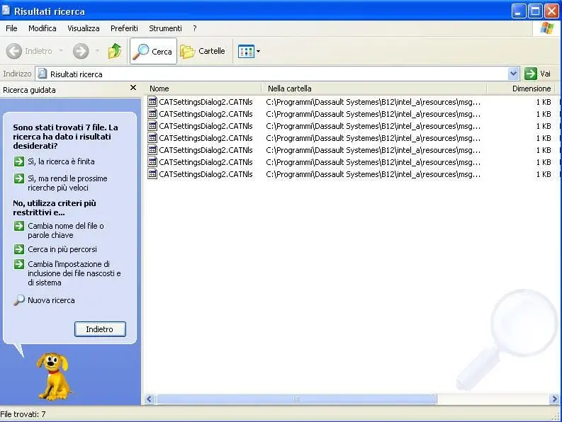

I have tried at least 1000 times... the problem is that I don't find the path.. or rather the directory.. If I do:
- options - set the directory of user resources - I see the infamous directory - catsetting, if I look for it with find windows I find only files that don't seem like the setting type... I don't know what to do. I place pictures so I can be + clear... If you can help me, I will be very grateful... I have to make drawings tomorrow. in these conditions I don't know exactly how.. thank you all... I really ask you for help. .

the directory you will probably have to insert (see your tree) is:
"c:\documents and settings\user\dati application\dassaultsystemes\catsettings"
look that it is the same directory where all the settings you make such as the menu palette layout are stored.

I have a doubt.. but we are sure that the path is c:\documents and settings\user\dati applications\dassaultsystemes\catsettings...? is not that this is good for the voice: catusersettingpath? ?
is it not that you have to create a new environment with a copy of the file in question? ?

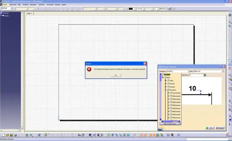

That's what I said. I sang victory too soon... now it gives me this mistake.. .
What do I do? ? ?

...the same tiritera of cattsettings but this time look for the directory "env" and insert it in the line referred to "catcollections...." what tells you that it goes wrong; even in this case because it is empty.
