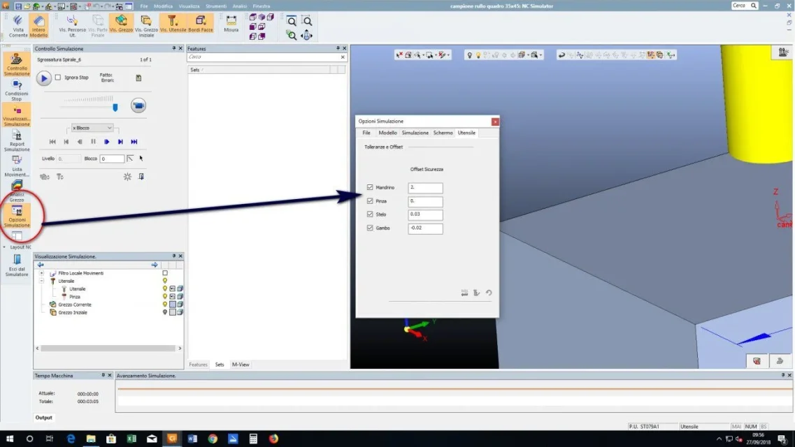

we are beginning to create the pliers library to get to work the machines not presided over, so it is important to check any collisions.
now, however, on the tools type cut to inserts, which have the lower stem of the actual milled diameter, the system "obliga" me to insert a clamp that has the lower stem equal or greater than the tool diameter.
This, however, causes numerous collision reports that do not actually exist because the stem is lowered than the cutting edges.
How do you eliminate this problem?

works on the definition of stems 1 and 2 in the tool definition table. but the heel where you report it ..in the simulator?
