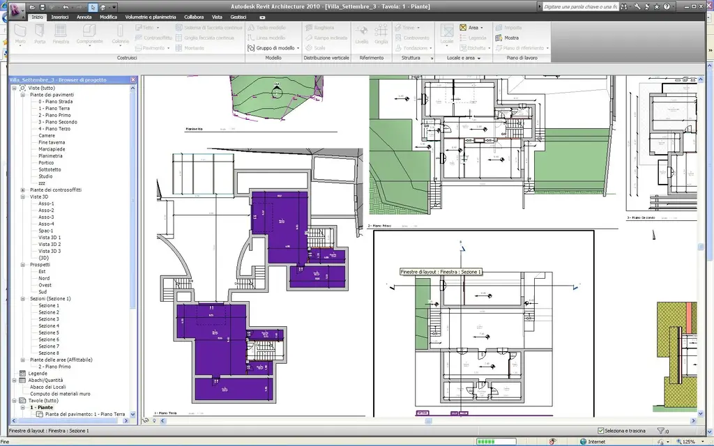

hello to all I have a problem that when I delimite a local on the ground floor is colored while in the rests slowly?? how do I remove or change the color and possibly insert the color? ?
Thank you very much
good work at all vito
hi frank no to the legenta I attach the file as you see on the ground floor the area of the vain is colored while the other planes are not, why not? ?
Setting problems?? Is it also good that you color the rooms and if I want to change the color? ?
Thank you very much
vito
view representation is in colored mode, selected by: visual properties> display style.
the two central floors, are mistakenly set as you see walls and doors below.
correct the "underground" field with: no one, or the reference of the specific plan, or the depth settings of the view from the field: Display range.
to change colors, from material properties (floor), use the parameter : surface pattern
