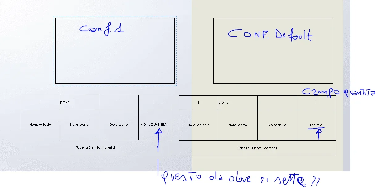

good morning to all, I would need a delucidation, when I have a set with multiple configurations, in putting into tables when I go to insert the material table, the column header quantity vine out different between the defaul configuration or cumunque the first one in the list and all the others, I place an image for clarity.distinta-metrriali.webpNow I ask where does the header set for additional configurations? ? ?
of course the writing (toc toc) I inserted it saving as distinct a custom model, and as you see the distinct of the conf.1 presents in quantity the word (0001/quantita')
thank you so much to those who can give me directions
no massive, I need to understand why defaul configuration the header can customize it, while for others I can't, in configurations after the first, column header quantity decides it him with this string "configuration name/quantity", my question was where can I change that header? ? ?

"do not add "quantity" next to the configuration name " this and clear and I see the operation, in meadow from the second configutration then removes the written "quantita" and leave me only the configuration name
"do not copy the name of the column quantity from the model", put this does not happen, as long as it fails to have it does not change anything, you know how it works? ? ?
I would need the opposite of what comes first, I should leave quantity and make the configuration name disappear
hi massive, I read the discussions you gave me and others I found on the net, but no one who answered me how it works
"do not copy the column name quantity from the model"
that from having to have not changed anything
Have you tried? ? ?
no but now my hand and if you understand how that tick works, the column name in the model where it is? ? ?
I didn't try.
the name, I have already written it, is the union of the configuration name plus the word quantity.
