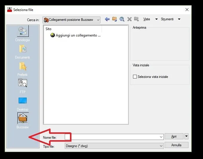

you can also add the folder in the window that opens at the launch of the command Open the door Immagine.webp
