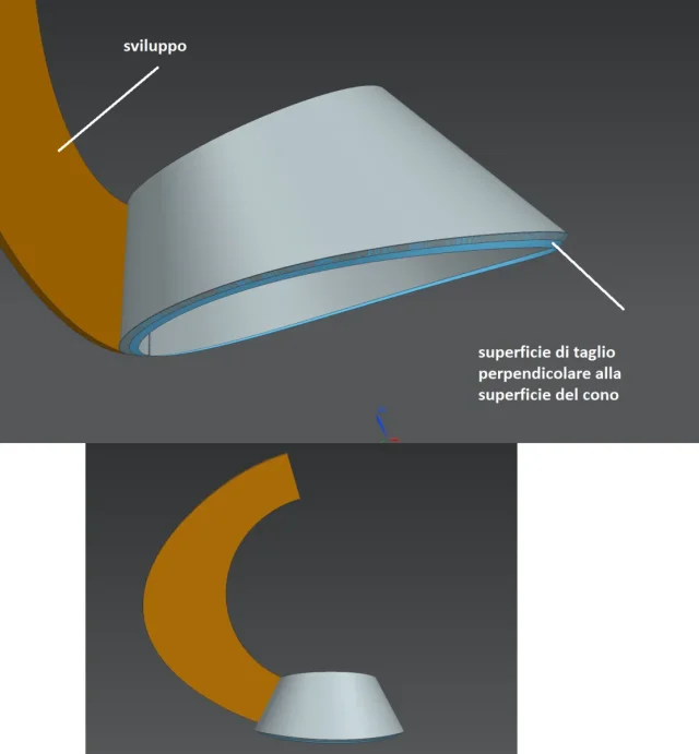

hi king....I saw the file....it would also be good done using the loft sheet...but with the folds...the problem and that it does not accept the 3d sketches and therefore having to make then the conical cut after...I would not have the correct background...and then return to have the same doubt...the developments that kicks solid on those maths are correct?
try to remake the loft sheet by choosing flattened and unformatted...and you will see that it does not accept the 3d sketch below

fgmec...turned and the most precise and mathematically correct result
resolid....see that your final cut creates an unrealistic edge on the bottom...so it is not good done so
baskets...exactly what does not correspond by quantity on the order of the tenth...are the internal or external perimeter according to the factor k to 0 or 1...I find the lengths of the developed edges not perfectly coincident to the model 3d.. and this only for the cones disassati
place an image to make you understand and you confirm me if with nx instead you correct them ok
