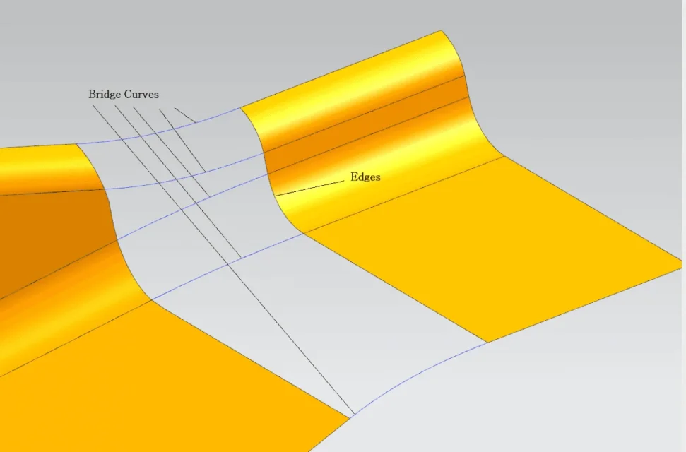

hello to all, I would need nx to create tangency or curvature connection surfaces such as yellow attached ones. thanks alessandro
I would do like this:
I create curved bridges (in blue in figure) and then I do a mesh through curves between these bridges and the remaining edges by putting in tangence the latter.tcm.webp
Thank you. I knew there was this solution but I thought there was a direct command to create the superfice without guides (I tried transition but it doesn't work properly).

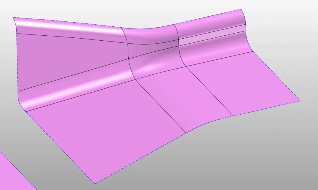

Yes, I did the same thing with zw3d and I would say that the method you were suggested is what gives you the best result. for very simple targets, one cad is worth the other;)
combined all in g2, here is the final result;)
