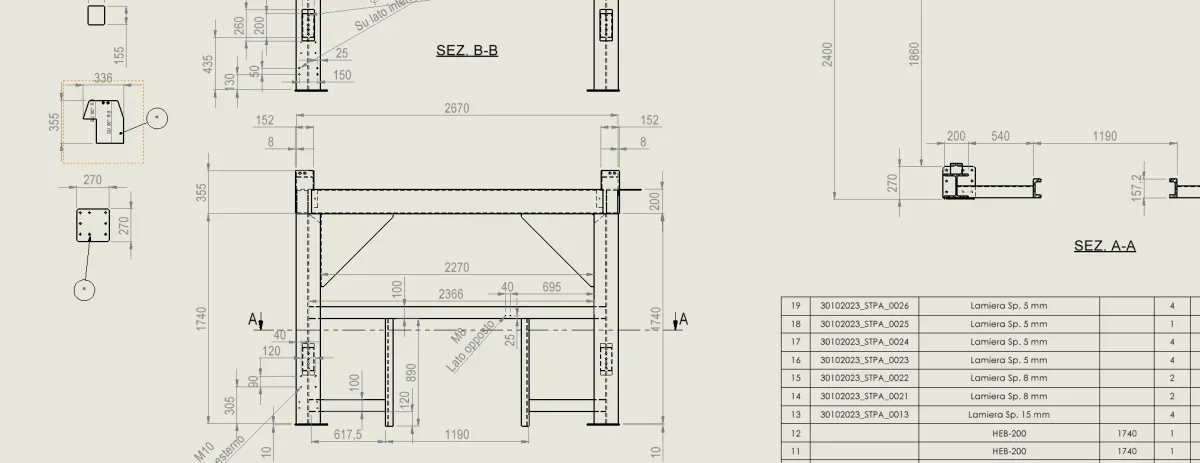

I refer to this debate, because I can no longer associate the table with the number of the details, as from the attached image. both that I turn the macro, both that manually associate through the property key the number of the part to the table always get an asterisk. . .Screenshot 2023-11-27 094406.webpDo you have any ideas in mind?
