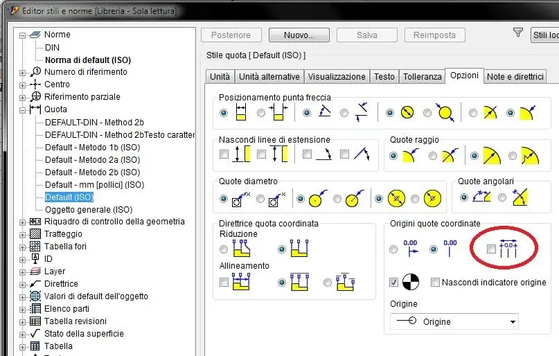

I open this new thread because I found nothing about the object.
according to you could automatically set the negative sign to the quotas placed on the left and below regarding the origin? it would be very comfortable for the millers, sometimes wrong towards and the piece is to be thrown. . .
see the attached image the sign "-" I put it manually before the quota.
Thank you! :finger:
once you set that check, if you had already quoted deletes the quotas and refractives automatically do not update
already tried, even with a new cartiglio but nothing (I also saved as default the new setting).
you are using the "coordinate" command and not the "coordinate group" command, this option only does it with the coordinate group.... at least I only work so
ah, here!! it only works with coordinate group! Thank you! :finger:
