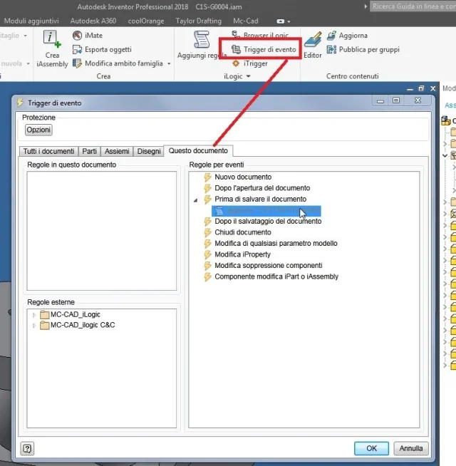

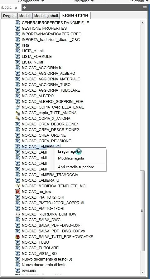

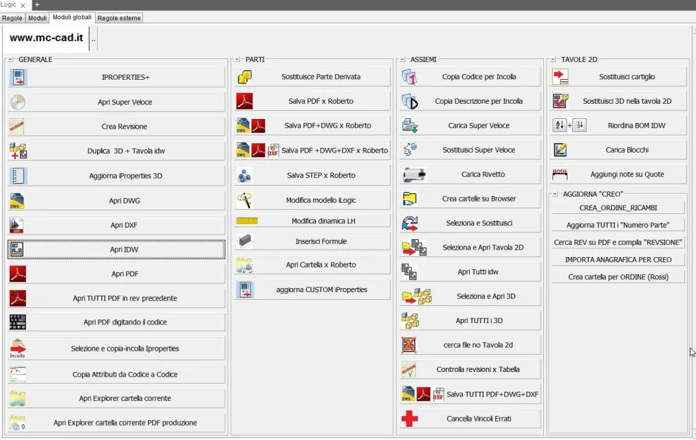

the best solution is to create external rules (saving files in folder) and then by calling the command through key creation or directly from the browser or automatically depending on the action you have to perform
command example recalled by browser:
_foto__128.webpexample of menu commands
_foto__129.webpor automatically via event trigger
_foto__130.webpin my opinion the solution to copy inside files is problematic, if then you have to make changes? ....

Thank you, you went far beyond the things I know to do, but the external rules I managed to create them. for now I will work with the event trigger that I will have to set up on each old file. in templates the trigger is already set. Thank you.
