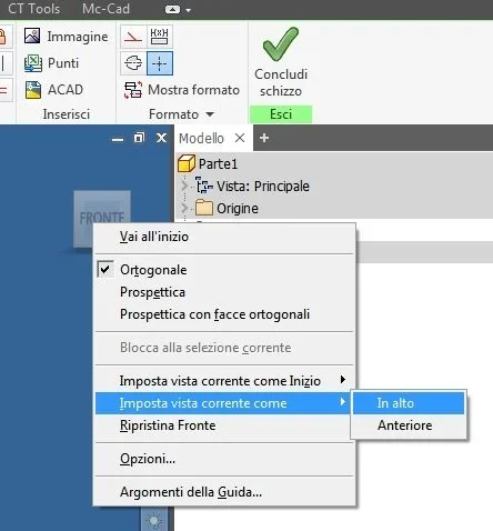

"I better explain, I would like that by orienting the view in "top" to have the axes oriented in x and y in plant and positive z upwards. "
go with the mouse on cube and then dx key, set current view as "high"_foto__288.webp

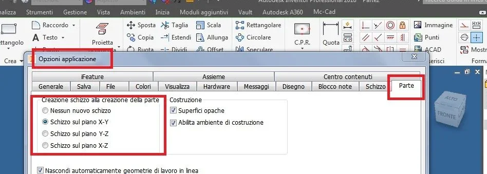

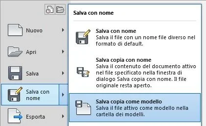

"I would like to have the ability to rotate axes at the template level so as to have x and y in the plant and z "going out of the screen" when they place the top view."after running the above command, save the file as a modelmodello.webpthen giving new file, you'll have the file with the correct setting
you can also determine the plan on which to perform the 1st sketch for the command "new part file"_foto__292.webpGood job
