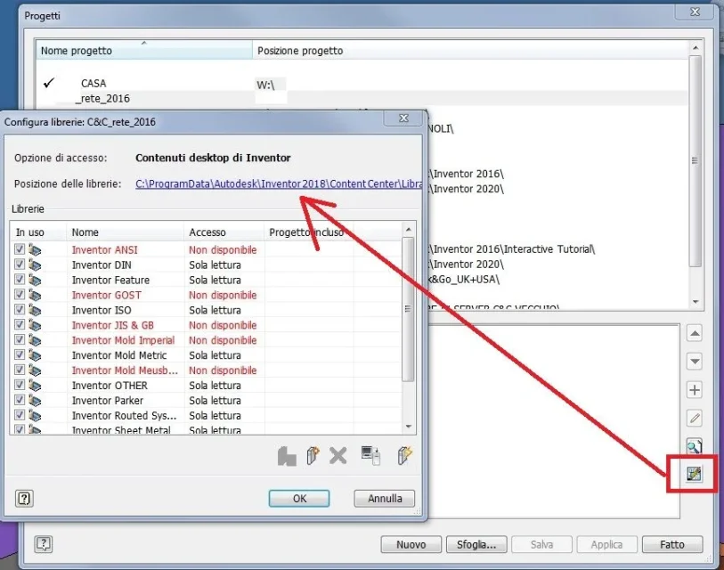

However for security someone can tell me the correct address where the libraries are loaded?
the path you find in:

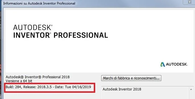

start - projects _foto__203.webphowever check even if you are updated with the service pack_foto__204.webp
