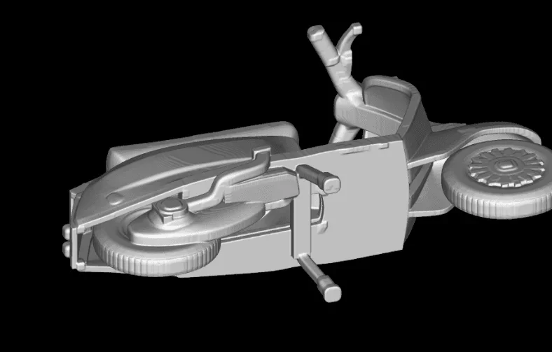

hi, I made some experience to correct stl models with holes and thin walls
