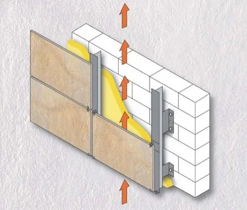

I have to create a particular in assonometry that shows the stratigraphy of a wall, in order to show, in scale 1:20 the various layers of the materials, that is the brick block, the insulating and the mountaineers on which the ventilated facade rests... Can you tell me how to revit? I attach a photo of a stratigraphy found on the internet, I would like to get a result similar to this.. .
facciata-ventilata-stratigrafia.webpThank you.

I presume that what is posted is done with two families: the wall (wall + insulation) and continuous facade (pannelli+staffaggi).
in my opinion, the stratigraphy of the posted image was built "art" with revit, but it is not obtainable as particular from a project wall, with the only command "stratigraphy"
