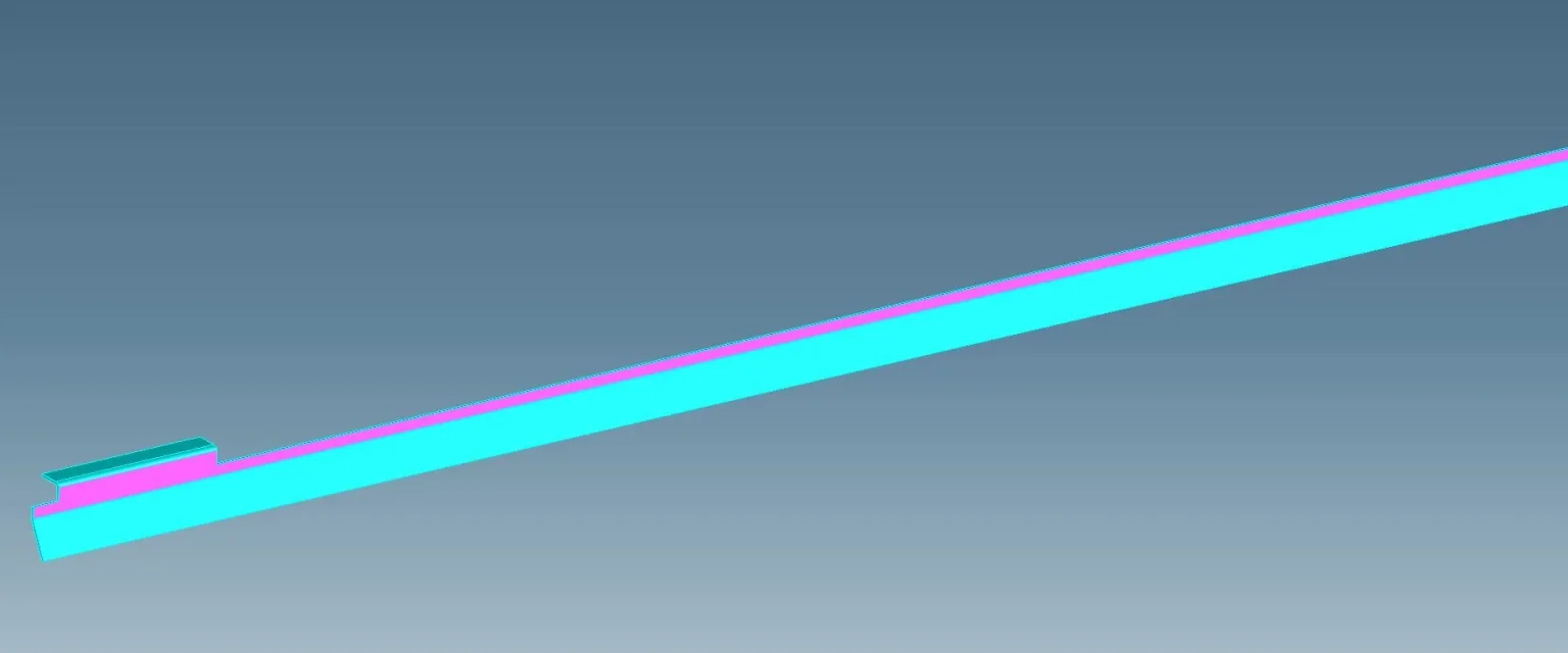

I use little this method but I would like to deepen it because sometimes and very convenient.
I leave from a sheet where I believe a protrusion with labro (fig1)
I create a group faces where I do not include the face highlighted because it is part of the whole part (fig3)
I try to create a series but it does not perform it because there are two faces (fig2) ....the one highlighted in the fig3 and the correspondent not in sight.
Do you have any suggestions?

I reversed the image name fig2 with fig3
a method you can use is to separate the faces of the hub using the "line press" command, then you can create the complete hub and make it the series.

Yes, this is the method I could use ...I don't know what happens when I go to spy on the sheet.
I didn't know if there were alternative methods...cmq thanks.
