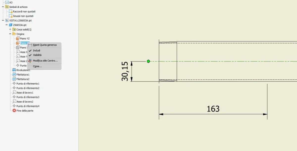

go to the "origin" of the part and include the axis that interest you, then use it for the quotations you need.
the question was the automatic projection of the axes in the sketch of modeling 3d I think...
