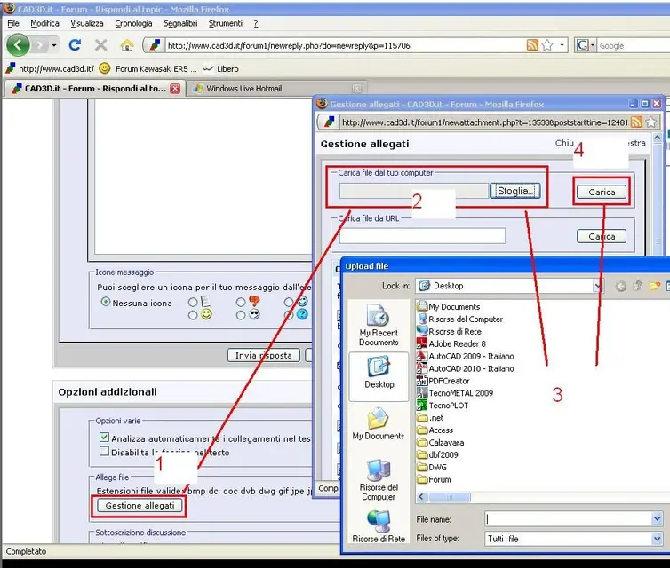

you must use the attached management under the response to the mess (obviously in advanced mode) if you do not know how to accerve you use the quota key under a message

ok thanks no I had never used this function.
