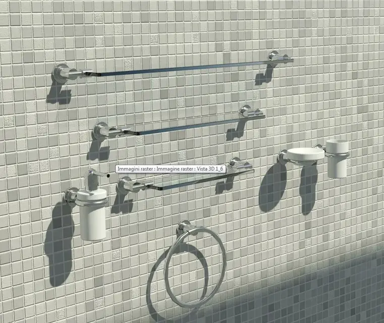

Okay.
the point is that for another door I had modeled these carts as extrusions, and the problem had not been presented to me... I then had problems to control quotas and dimensions, so it seemed like a cool bind them to a reference line.
p.s. congratulations for the work, really beautiful! :smile:
I actually did some tests when I was building those accessories because I noticed this problem
those accessories had been made with 2011
with 2012 should not be there.
they tell them
I have here also 2012, but for various reasons I have not yet installed it
so I didn't check
