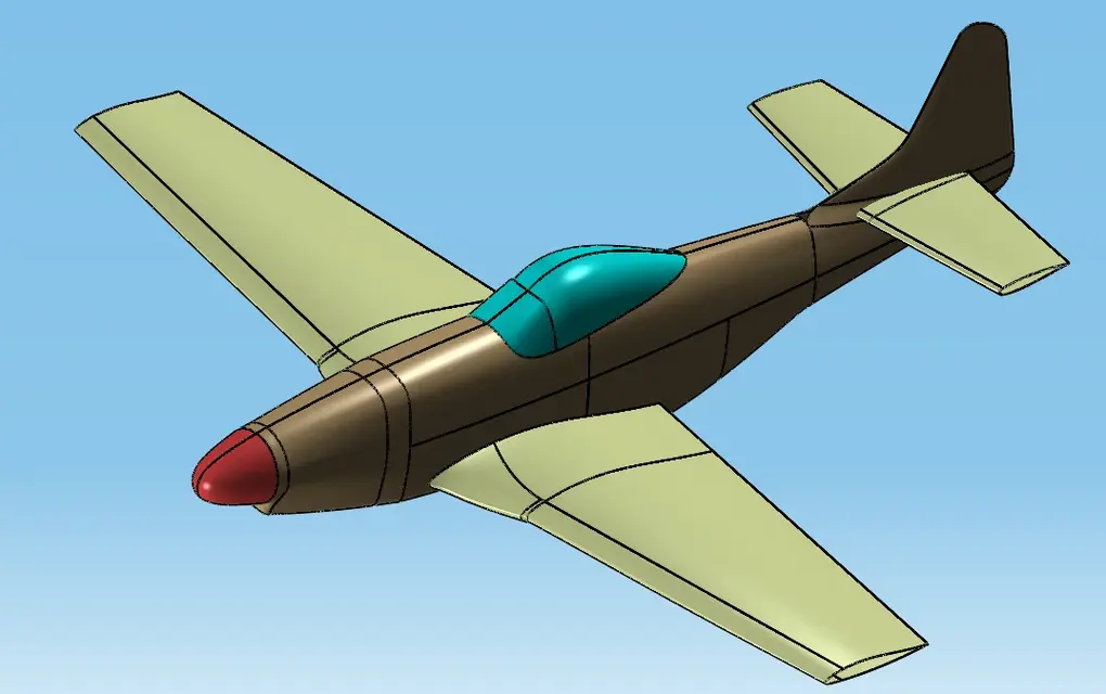

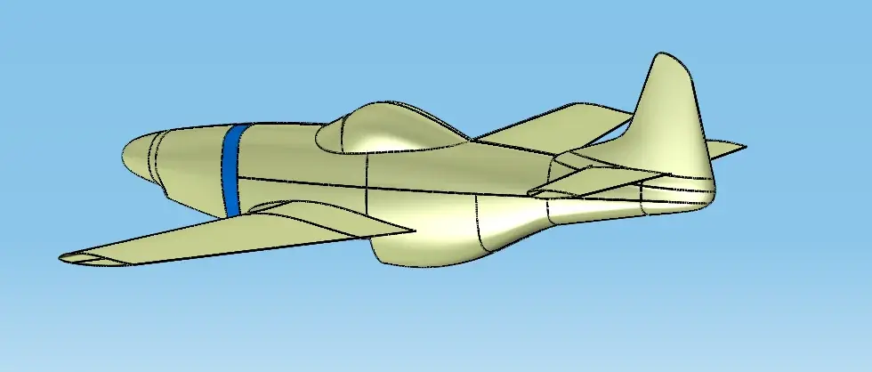

to which there are there the completed place goes..:biggrin: thanks always to all of you:finger:
