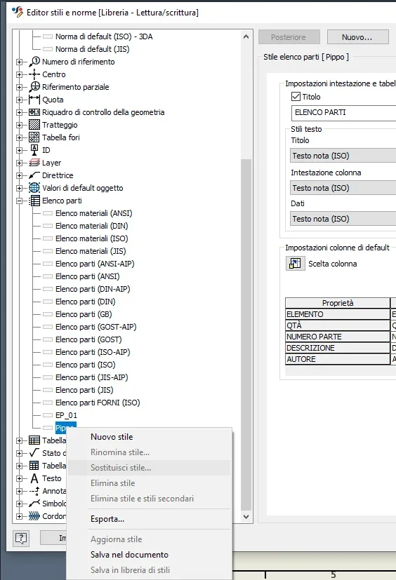

1_ apro editor styles1697571631787.webp2_ created new style poplar from an existing and added random columns
1697571866187.webp3_ save in the libraries that appear here
1697572013340.webphere from now on using the iso standard I should find the pippo style and if I want it as default I select it from here:
1697572154915.webpDo I take the correct steps?

Besides if I have the bookstore styles in reading writing why can't I delete the styles??
the option is in grey not selectable.
but who made these styles a mental depotentiate?? ?
are unavoidable.
you probably have inserted the style into some set of default objects, and then (also logically) does not allow you to delete it. verify that it is unchecked from any where and should get it removed.

try to see that "standard " is inserted if you created that style in the rule of defoult does not erase it550dsJ0RVZ.webp
