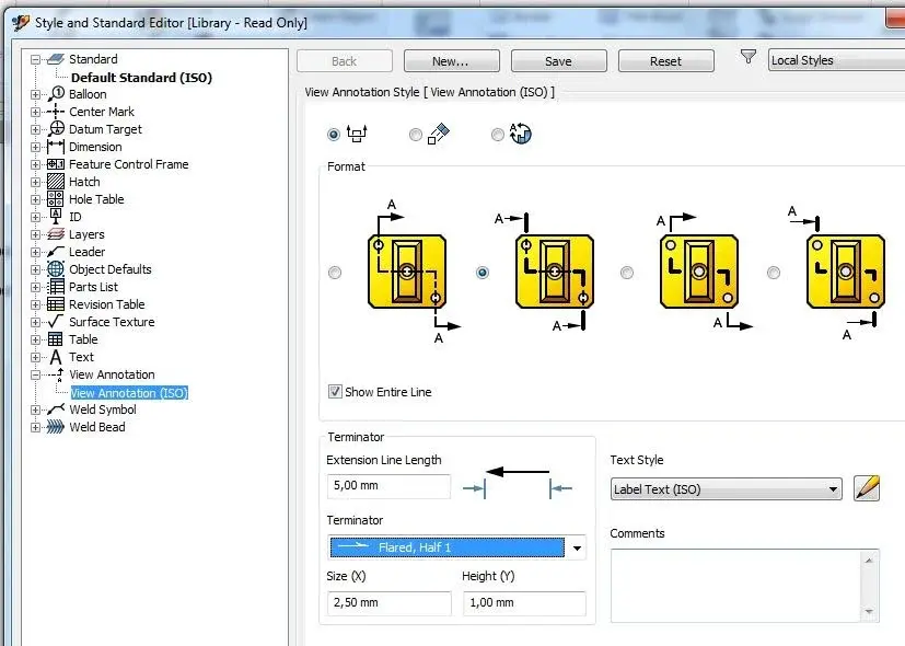

the idea of stefano.
if you want to change the style of arrows you can go to the style editor, but also there you are forced to choose from the proposed alternatives.
the section letter changes quietly at will, without having to be a block with attributes.
if you are stubborn with a symbol (for habit...for maniacality. I don't know) I think the only one is to set up an arrow "none" in the style editor, and then manually insert a symbol made by the user or imported by autocad through the sketched symbol folder in the browser or by "annotate/user".
