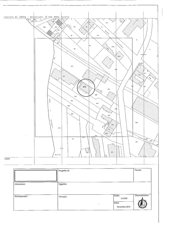

preview of print I see how I would like to be printed, that is dwf within my frame, but when I receive the print I see the extended dwf outside my trim edges.
I tried with dwfframe 0, 1 and 2, but always the usual result.
That's right.
This is an example.
Here we go. what I see on the monitor, This is what I see in print preview and This is what a scan of the press.

depends on the dwf file, not the drawing.
I checked on a new file.
do you have the original pdf?
I tried on a new cad and the usual dwf and I always feel the usual problem.
I also have pdfs, but I can't import them directly to the cad.
in the usual file I also have a crop of another dwf and that actually is printed perfectly to me.
I tried both on your file and on a new file: printing without problems.
try to detach and hang up the incriminated dwf or change the path.
tried by changing the path, I put it on the desktop: nothing to do.
But is it not that I will have some modified print settings?
What autocad do you have? I am with 2009
I tried it with 2013, and as mentioned before, with your dwf file the problem is also present on a new file. The same is your problem.
only joseph works.
with what did you create the dwf file?
