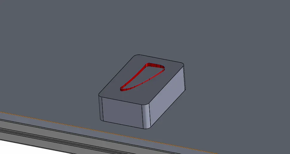

I found the command "cut with surfaces" at lasteee (thanks a thousand @re_solidworks), I extracted the surface of the piece (red surfaces) with the command "unisci" (I think it is right like this). But now it doesn't make me cut the solid with the fateful command
Where am I wrong?

to understand and give you advice you have to put in transparency the grey solid.
You don't understand where the red surface ends.
I suspect the surface doesn't completely cross the solid ?

Does the surface close inside the solid? if it is open it is not possible to cut. would serve the model to understand well. If you have to make a hollow type mold, you should make a boolean between solids, without going through the surfaces. If you are in the environment together you can use the cavity command.
@re_solidworks I can not use the boolean..the boolean allows to see a solid with another solid.. I have a solid to cut with a surface@vittori here is the screen you requested

but in fact it is perfect.. I can't really understand why not cut
Is there a way to find any holes?
I could help you if the problem was in the catia section, solidworks I know little, surely there are experts who will give you advice.
One thing is certain, with all the cads cutting a solid by surface, the latter must be perfect.
especially in your case, it is not any surface, but a group of surfaces sewn together.
Just a micro hole.. and the cut is not possible.

close the top of your red surfaces with a flat surface, transform that new set of surfaces into solid.
if even this fails to confirm that your red surfaces have openings
