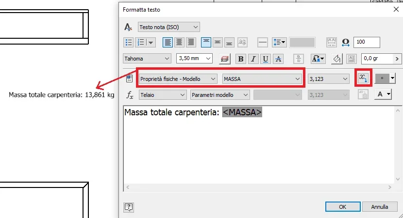

Hi, if you used the chassis generator, in the list parts of the table must activate the union of the rows by selecting as first key the number of warehouse.
the result will be 1 row per profile type.
the total length will be added automatically in the qta column, but the mass must be forced by hand because in the cell will come out *vary*.
As for total weight, there is no function in the list of parts to add a row that matches the row values in the table, so a row or as a custom part should be added or creating a manual table with 1 single row.
Alternatively, a note or text can be inserted into the table by connecting the mass of the axieme.
