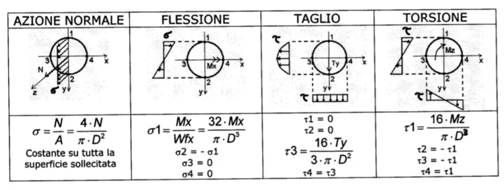

I ask kindly support for the sizing (approximate) of the diameter of the stem of the hydraulic cylinder represented in figure.
basically the stem of an oleodynamic cylinder has a f force of 43'000n applied at the end and this cylinder passes through the hole of a fixed support (the various masses are ignored, the bike of the cylinder). you can consider contact between the support hole and the stem as if it were a skate
material is 39nicrmo3 with rm=1000[N/mm^2] what puts me in trouble is how to consider cutting stress and stinging moment together.
Thank you and wish you a good day.
