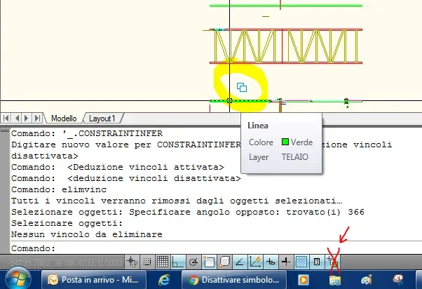

Hello everyone, I didn't know how to search for this little problem I first encountered. I attach the image to you, and I ask you what it is, and how does this thing appear on the polylines?
thanks in advance
It's the bond symbol.
you have entered, perhaps inadvertently, a bond.
elimvinc command if you don't need it.
Hello.
when is it useful or even necessary to work with "deduction of constraints" activated? .
hi and thanks, I add that, even after putting into practice the vs suggestions I continued to see the symbols of the constraints,
I solved by also checking "cyclical selection" in the bottom bar.
