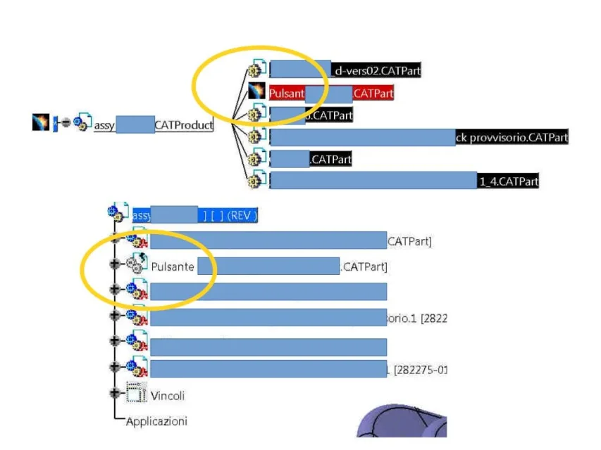

I put an image of the axieme and the tree... The subassieme in orange is the offender, while everything else is done here by me...info.webp

for me is a spy that means that that .catproduct was probably saved inadvertently (by name) ...

Dear Gianni... of evil in worse, now as is the axieme is complete of the parts that have sent me.. I have other sub assemblies to add but they are mine, so without problems.. .
bad worse because now errors seem increased, and all derived from his files.... I look for the infamous white gears. I'll take you anyway. .info.webp
I don't find any files with white gear, and above all with strange names... I don't know how to get out at this point. .
Can't find files with white gear? I'm sorry, but it seems very strange to me, isn't it that you're working with open drawings and you didn't say that?
