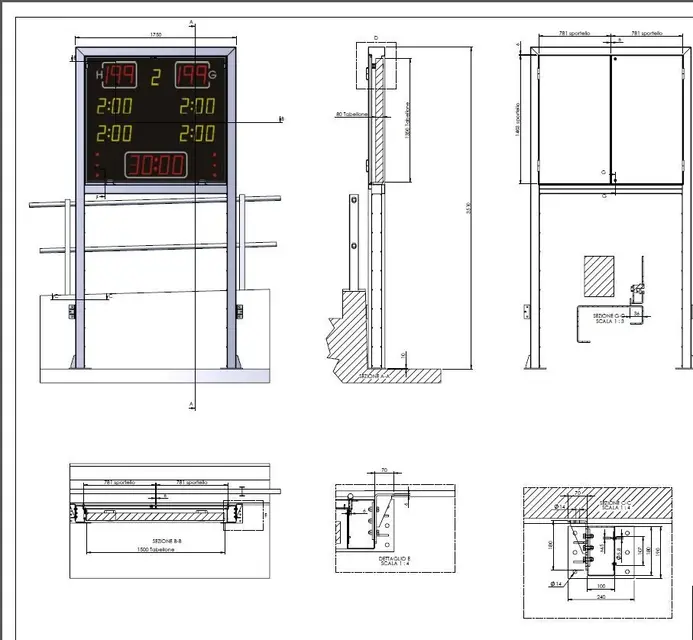

I didn't remember anymore, years ago I did this....
