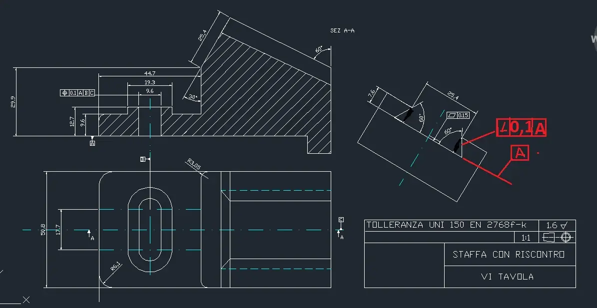

design control on autocad
  • Thread starter Thread starter ornitorinco91
I told her to prof.. and she said to me that I am in sight:)
for the toll. of inclination is well done so?:
Yes, tolerance is fine
for the lines look as I did: I erased them completely. I'm not here.
pier arg, even in my opinion, but many people say they're in sight, including... I'm going to put them... If he says that they don't work well,
however put the name of the auxiliary view and the arrow indicating the direction of the view (see attachment of mauri:66 on the first page)
the arrow I tell you with b
above the auxiliary view, instead, should I write : auxiliary view or b (like arrow)?
you put corners that do not exist; Those lines are not that "they are in sight", they are not there.
missing odds.. also put the maximum dimensions "everything out", to understand the flight that measures will have the piece for the supply of the material. If they're redundant, you put them in brackets.
indicates that the longitudinal axis identifies the halfworks and the piece is "symmetrical", or you have to put the quotas on the axis.
use different colors for odds and sectional restraints.. In addition to confuse with the edges of the contours in the printing phase you will have problems in differentiating the line thicknesses.
more space the views and put the odds "more out" from the piece, so they are all attacked and the lines get fucked... I mean, it also cures the order.
