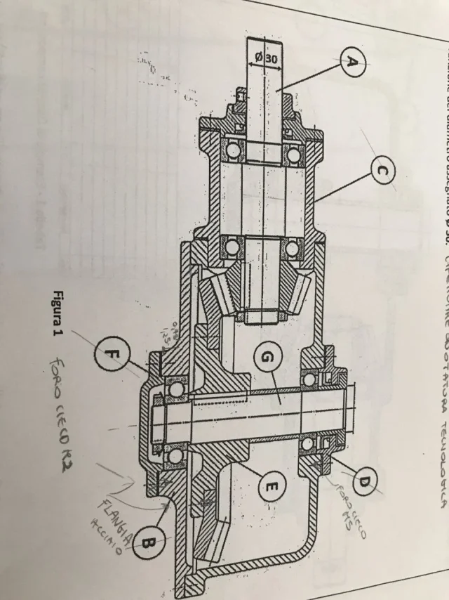

I would not even mount ball bearings, but they can bear in a combined way even the axial load. We don't know the couple to pass on.I ask who is more experienced than I am: does the drawing from anna seem correct?
I am referring to having ball bearings on shafts with conical wheels, as if there were no axial thrusts.
It is true that we do not know the entity of the couple (and therefore of the axial force) but I would never venture to put ball bearings instead of tapering rollers.
