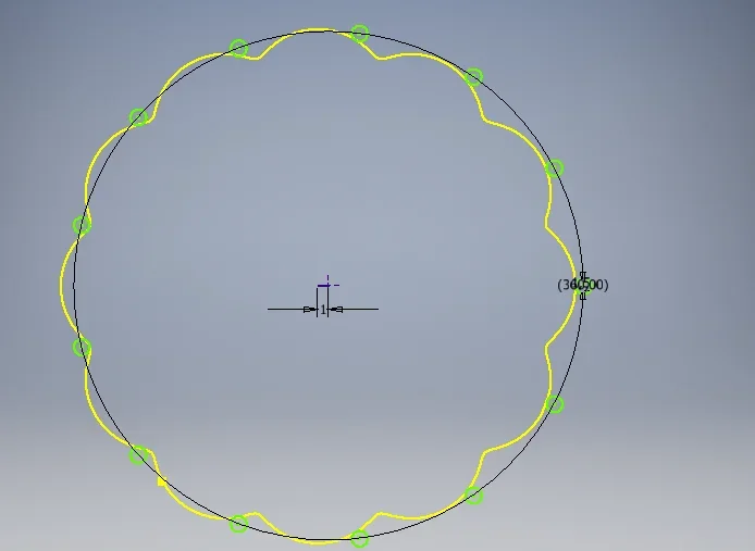

I am designing a cycloidal reducer that presents a cycloidal disc with 12 teeth with diameter between a tooth and its opposite of 47,5 mm, moved by an eccentric with distance from the center of 1 mm, which rotates around a crown with 13 reels of diameter 1.5 mm.
I managed to make the cycloidal disk, but now I'm in difficulty in placing the reels so that they are always tangent to the cycloidal disk.
I had thought to place the 13 reels along a circumference centered in the eccentric (i.e. a circumference whose center is 1 mm from the center of the cycloidal disk), but thus doing not all the reels are tangent to the disk, but in some cases overlap... I attach some pictures to better explain my problem.disco cicloidale con rulli.webpsovrapposizione rullo con disco cicloidale.webpCan anyone help me?
Hello merolla,
I have always been fascinated by such types of reducer even if unfortunately I have never tried (if you have specific material in this regard I am happy if you pass it:biggrin:).
in my opinion you should focus on the polars of the motion of such cinematism and in turn determine the conjugated profiles that allow this movement, thus determining the geometry you need. I attach you a piece of explained file in a very simple way that could be useful to you.
