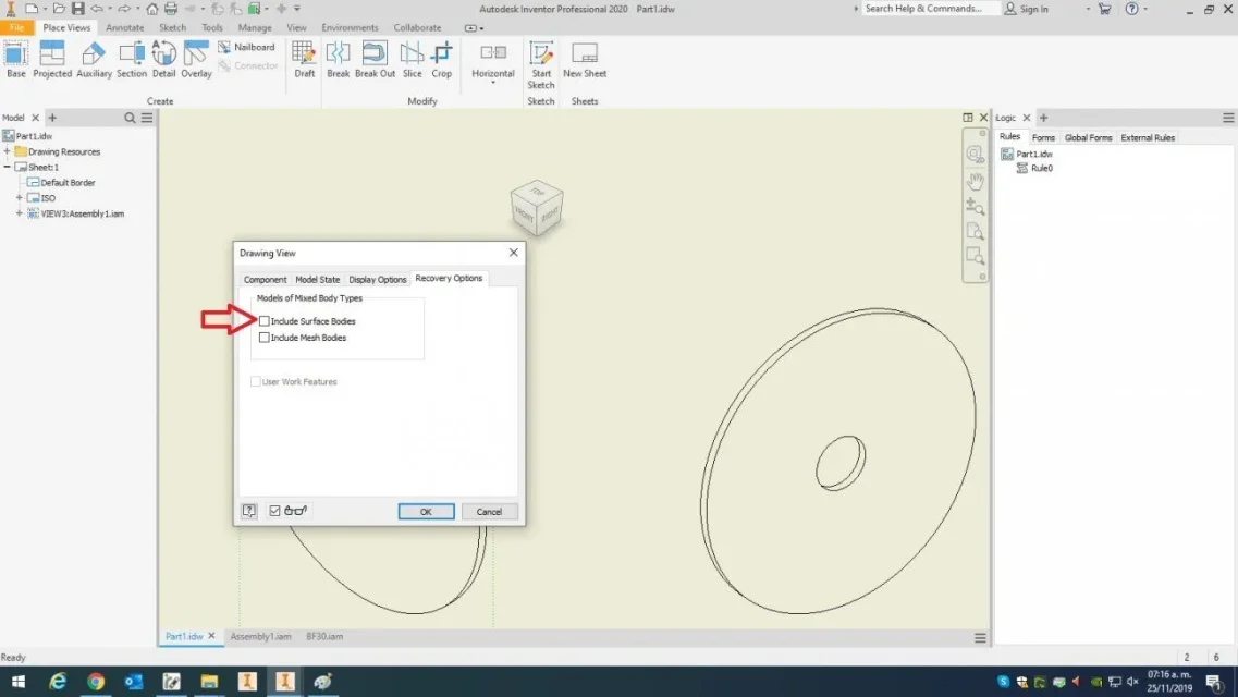

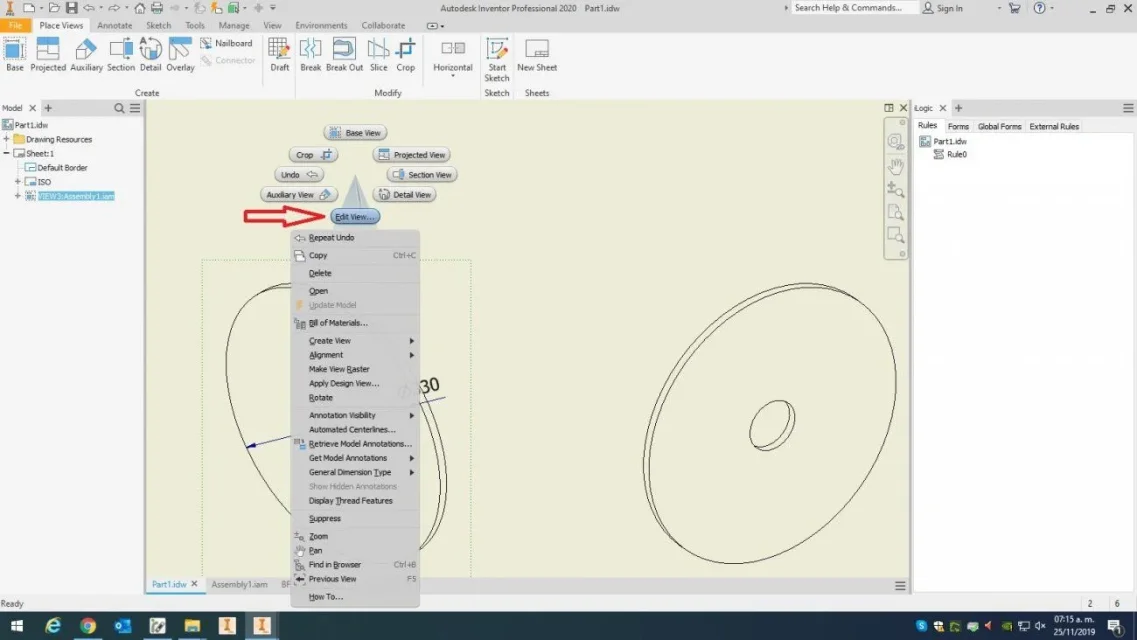

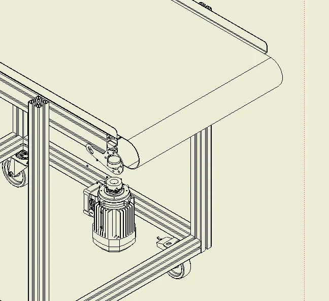

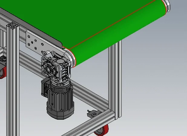

hi to everyone, working with inventor2020, sometimes I happen that in 3d I see all the details, and I have no messages of error, but in the table, as by magic, some details disappear, I attach photo to explain myself better,
Did someone have the same problem? I can kindly help me find a solution.
