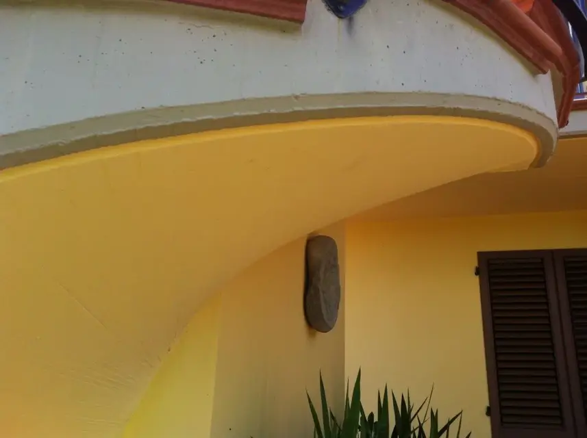

Thank you for your compliments, but I assure you it is very feasible. It remains to be seen if the customer is good to spend to pay the trouble of such a complex realization. a similar scale I made it 7/8 months ago and came great, happy customer and ready money at work. I attach photos.

Please! :) I have a great experience on the yards but given the quotas I imagine it is an internal ladder that had to connect a attic or something like with the underlying plan ....so little to spend on polystyrene .certo that in the yards today as today it does everything .poi maybe I have the fixed for this type of solutions .we have to say it pero, to the forumists that raises are done after the walling, cmq I appreciate his achievements... precise and accurate work.
