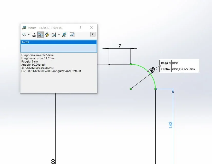

Hello everyone,
Can you tell me the fastest way to get the development of a bent tondo like that posted? I have to bring the cutting length back to the table.
Thank you as always in advance all for any given answers.

If you do it with the structural members and indicate the union of the curves you have the automatic length.
or if you've done a single sketch, use the route share.
or if...
or if..
with the image alone you can not give the best solution.

Hello Mass, and xxfast,
In fact massive this round comes from a step file, the customer asks me to do it again with sw and to develop the table indicating its cutting length.
I'll put the full file.
But how do you pity him? is it not that it is made with welded curve?
not being able to see the measurements (maybe it is a diameter of 2000) the development of the folded pipe or of a metal plate and bent?
I ask:
if I follow the following calculation: 7+12.57+142=161.57 is correct as theoretical development?
could be folded and then cut.. I have not given particular specifications, this is one but there are several others even with longer ends. .
thanks massive and also to you xxfast, you are as always very useful and exhaustive.
