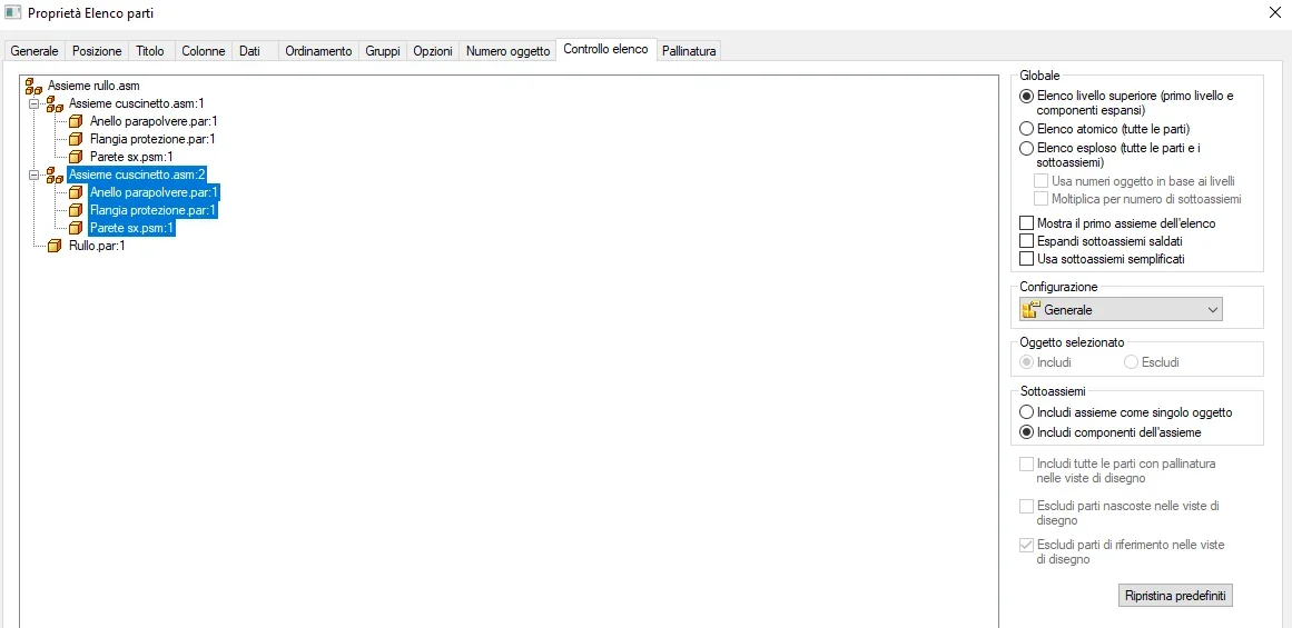

I carry a screen shot for example. the properties of a part or together with a distinct part level reside at the draft level and not the correct 3d model?
if the subaxieme highlighted I put it in new together, the choice made to dx " include components of the assieme" and a property only of the draft in question right?1698563310487.webp

Hi, the answer to both of your questions is yes.
in the image you are displaying the properties of a list parts accordingly resides in the draft; the properties of the parts in a set imposed by the assieme through properties occurrence.
Thank you. but the properties occurrence of a subaxieme are valid in any assembly in which it is mounted or only in the one in which it is defined?
depends: if you define them in "propriety' occurrence" in the 3d then you find them also in the next draft you go to do, if instead you define them in the propety' of view they only apply to that draft.
remember that the properties' occurrence are information that influence the behavior of a certain part/subassieme, but are saved in the assieme father that contains the above parts/subassieme, not in the parts/subassiemi. The same
So there is no system to define once only the behavior of a part/subassieme in a distinct part? Do I have to redefine behavior all the time?
depends on what you want to get. What do you want to get?
for example a subaxieme must be included in the list parts as a single object always. it is possible to define this feature only once or is it necessary to set it all the time in the properties list parts-->control list?
you must define it as "saving", then in that case by default it is not exploded. the information in this case is inherited even when you clean the subaxis in other assemblies.1701613399673.webp
