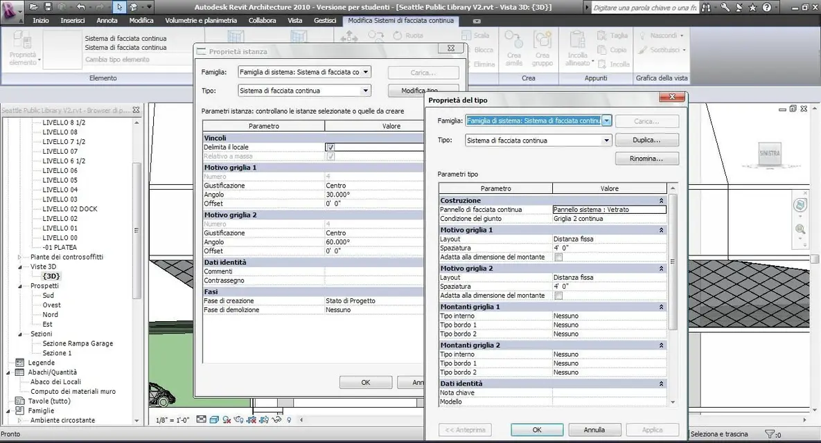

thanks gfrank, after a myriad of evidence I finally found which can be the discriminant that generates error. we say that in principle having all these inclined things does not help.
As seen from the 2nd image above, the departure of the mounts to the base is never equal, but tends to climb, and this thing already has suspicious me. the motivation is that I had defined the same number of mounts (vertical and horizontal), then tilting them 30° and 60° to achieve the rombo effect.
Unfortunately if the mass on which you work does not create a nice regular rectangle, it is not said that the spacing between the inclined mounts in a sense is equal to that between the inclined mounts in the other (the thing is verifiable in the properties of the continuous facade), and this generates errors like what I have highlighted.
you have to place the fixed-distance mounts (in my case "4 us feet") and the problem is solved (following image of parameters).
creating the "all grid lines", the software will complain only that it will not be possible to create some mounts too small and blah blah blah blah. give him reason and you will have your facade done and finished.
