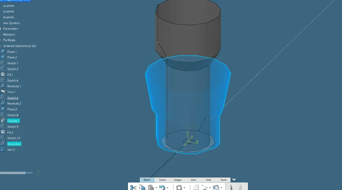

Good morning.
I created the attached component. Following an error command for a trim that the program could not perform, some components are fucked by display on display. the components, however, if selected, appear in heaven. How can I solve this, please?
advance already that in the infrastructure-3dshape infrastructure-display in geometry area is all unchecked.
I think it happens because you are in an ordered geometric group, so you see the features according to the history.. .
now you are active on the sketch6 (the one underlined), then the next appear as "fantasmi" but there are.
select the last feature (or the ordered geometric group) and then dx key define in the object of work and should appear.
Let me know.
Let me know.
solved so
Thank you
