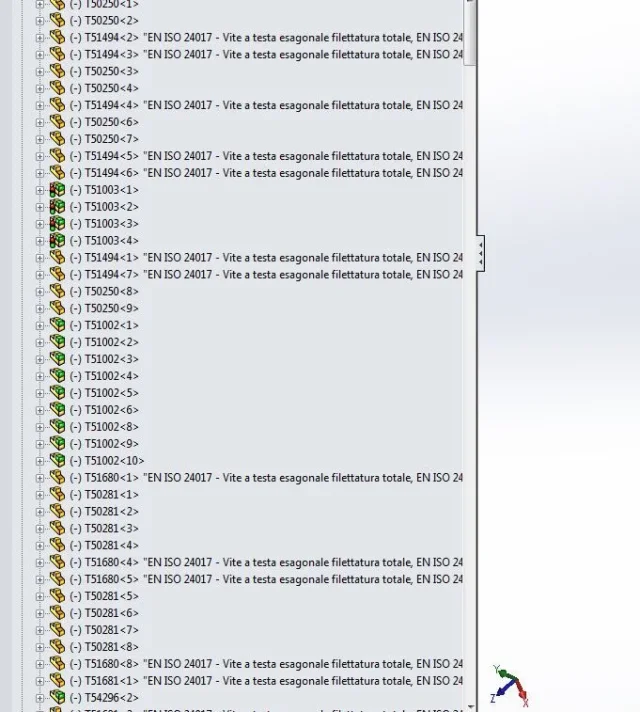

you are present, but you have made me notice one thing those few of which the description is displayed have an extra voice "description" to which at this point it is connected the whole.....how do I make sure that at this point "fish" the data from the description item and no more description?
Thank you very much
excuse me but I don't follow you, I don't understand what you mean...I have parts that in custom properties have extra voices, "description" whose voices, I don't want them to be added to the other parts, the three parts all the time they are created and saved, through the pdm are encoded and I add a description that ends in the vode description of the custom property table...I would like that when I click
maybe I didn't explain well, change it I can't because and already present and then it becomes twofold, and then at the moment when I change it doesn't show it anymore since it displays the item description......I would like to decide the voice that calls and displays at the moment when I select it shows description of the function
do a mini set with two parts, one with the correct view and one no. check that the problem arises as highlighted by you and then attach files with a pack%go
just add a voice description in the properties, the reverse of the one indicated before, but still possible with a short reasoning and with the files under the eye
if in one part the voice description the description and in the other the voice description there is not and does not appear the description is little to pull the sums
bho, to me it seems to have said immediately that appears when there is description and not viceveresa, little matter...........the solution in a set of 100 and + parts therefore would be to add the item description to 99 parts if only one has the described item? What I asked is there a way to reverse the link and link the description of the part to the description item rather than description?
