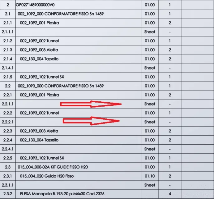

I have a problem with detailed distracts. I need to create my distinct materials by using the re-entry, so that I can view all the components of my sub-axis. everything works well, i.e. of every group I also see the details that compose it, dividing the details of the subaxiemi with the "." so the details of my subaxieme 1, will be displayed as 1.1,1.2 etc. . . the problem arises when I meet a particular sheet type. automatically explodes the detail with its separate cut by bringing out a "sheet" item that I would not want to display. at the moment the only solution I found and go inside each sheet component and disable the item "distinct exclusions of cut". the method is too slender and if you have multiple parts of sheet the thing becomes endless with this solution. Is there a way to automatically exclude cutting parts from separate materials with recess???? I attach screen of voices that I would not appear in my distinct.

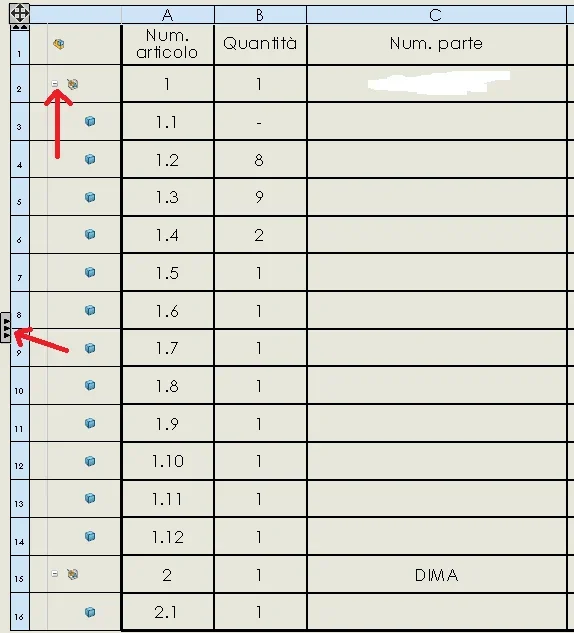

something fast I couldn't find him.
for now the solutions I can propose are:
-expand the cut-off with the curtain to the left of the same and hide the cut-off (see picture 1)
- clear the cut distinction from the side (if possible obviously)

yes I have used solution 2, delete the separate cut on the side, but where there are several sheet parts becomes long.. thanks anyway for the advice
